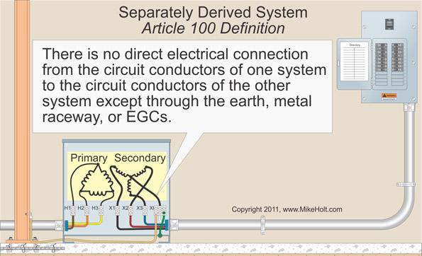

Q. What are the grounding electrode requirements for a separately derived system, such as a transformer? [250.30(A)(4)]
A. First of all, let’s define a separately derived system. According to Art. 100, a separately derived system is a wiring system whose power is derived from a source where there’s no direct electrical connection to the supply conductors of another system. Transformers are considered separately derived when the primary conductors have no direct electrical connection from circuit conductors of one system to circuit conductors of another system, other than connections through the earth, metal enclosures, metallic raceways, or equipment grounding conductors, as shown in Fig. 1.
Fig. 1. A wiring system whose power is derived from a source of electric energy or equipment other than the electric utility service.
A generator having transfer equipment that switches the neutral conductor — or one that has no neutral conductor at all — is a separately derived system and must be grounded and bonded in accordance with 250.30(A). Note 2 in this section states: For non-separately derived systems, see 445.13 for the minimum size neutral conductors necessary to carry fault current.
