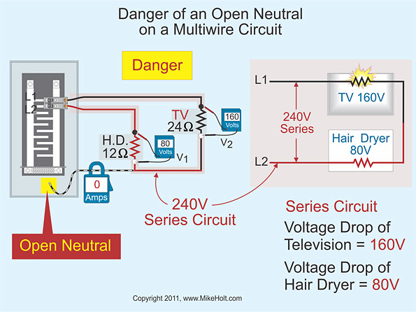

    Q. What are the Code rules for multiwire branch circuits?
    A. A multiwire branch circuit is one that consists of two or more ungrounded circuit conductors with a common neutral conductor. There must be a difference of potential (voltage) between the ungrounded conductors and an equal difference of potential (voltage) from each ungrounded conductor to the common neutral conductor. A multiwire branch circuit can be considered a single circuit or a multiple circuit [210.4(A)].

    Fig. 2. In this example, we see how the voltage remains constant across two different pieces of equipment when the neutral is in place.
    Caution: If the continuity of the neutral conductor of a multiwire circuit is interrupted (opened), the resultant over- or undervoltage can cause a fire and/or destruction of electrical equipment (Fig. 2 and Fig. 3).

    Fig. 3. In this example, we see how the voltage changes significantly when the neutral is opened in this circuit arrangement.

    Caution: If the ungrounded conductors of a multiwire circuit aren’t terminated to different phases or lines, the currents on the neutral conductor won’t cancel but will add, which can cause an overload on the neutral conductor.
