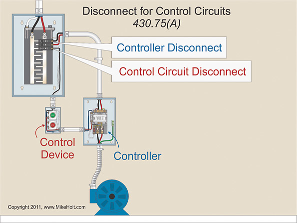

Motor control circuit conductors must have a disconnecting means that simultaneously opens all sources of supply when the disconnecting means is in the open position [430.75(A)]. If the control circuit conductors are tapped from the controller disconnect, the controller disconnecting means can serve as the disconnecting means for the control circuit conductors [430.102(A)].
A disconnect for the motor control circuit is required when the control circuit isn’t tapped from the controller disconnect. The control circuit disconnect and controller disconnect must be adjacent to each other.
If the control circuit conductors aren’t tapped from the controller disconnect, a separate disconnecting means is required for the control circuit conductors, and it must be located adjacent to the controller disconnect (see Figure).
