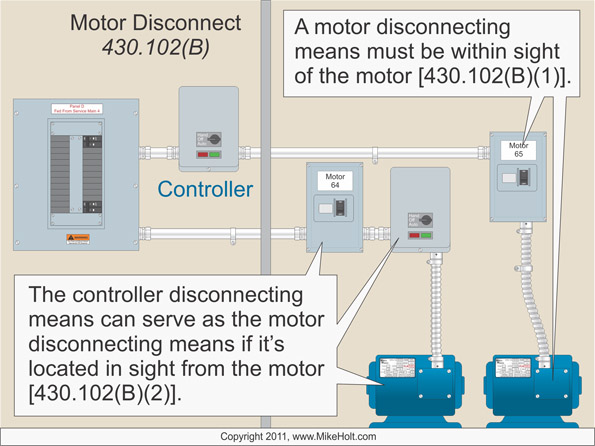

Q. What is the NEC requirement for disconnects for a motor?
A. A disconnecting means is required for each motor controller, and it must be located within sight from the controller [430.102(A)]. According to Art. 100, “within sight” means that it’s visible and not more than 50 ft from one to the other.
A motor disconnect must be provided in accordance with either one of the following [430.102(B)], as shown in Fig. 1.
Fig. 1. The NEC defines “within sight” as being visible and located no more than 50 ft away.
• A disconnecting means is required for each motor, and it must be located in sight from the motor location and the driven machinery location [430.102(B)(1)].
• The controller disconnecting means [430.102(A)] can serve as the disconnecting means for the motor, if the disconnect is located in sight from the motor location [430.102(B)(2)].
Exception: A motor disconnecting means isn’t required under either condition (a) or (b) if the controller disconnecting means [430.102(A)] is capable of being locked in the open position. The provision for locking or adding a lock to the disconnecting means must be installed on or at the switch or circuit breaker, and it must remain in place with or without the lock installed.
(a)  If locating the disconnecting means is impracticable or introduces additional or increased hazards to persons or property.
(b) In industrial installations, with written safety procedures, where conditions of maintenance and supervision ensure only qualified persons will service the equipment.
Informational Note 2: For information on lockout/tagout procedures, see NFPA 70E, Standard for Electrical Safety in the Workplace.
