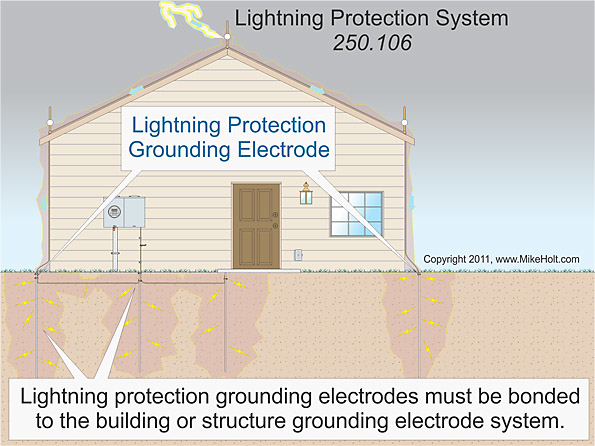

Q. What are the requirements for the grounding electrode system when a lightning protection system is installed on a building/structure?
A. If a lightning protection system is installed on a building/structure, then it must be bonded to the building/structure grounding electrode system [250.106] (Figure). The grounding electrode for a lightning protection system must not be used as the required grounding electrode system for the buildings or structures [250.60].
The grounding electrodes for a lightning protection system must not be used as a substitute for the required building or structure grounding electrode.
Informational Note 1: See NFPA 780 — Standard for the Installation of Lightning Protection Systems, which contains detailed information on grounding, bonding, and side-flash distance from lightning protection systems.
Informational Note 2: To minimize the likelihood of arcing between metal parts because of induced voltage, metal raceways, enclosures, and other metal parts of electrical equipment may require bonding or spacing from the lightning protection conductors in accordance with NFPA 780.
