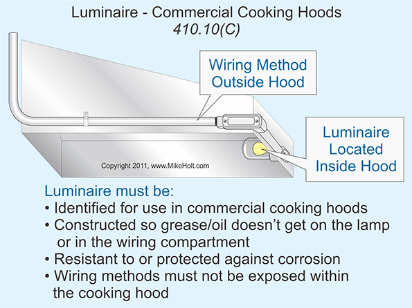

Q. What restrictions does the NEC put on the installation of luminaires in commercial cooking hoods?
Find the Answer
A. Luminaires can be installed in commercial cooking hoods if all of the following conditions are met [410.10(C)]:
• The luminaire is identified for use within commercial cooking hoods.
• The luminaire is constructed so that all exhaust vapors, grease, oil, or cooking vapors are excluded from the lamp and wiring compartment.
• The luminaire is corrosion resistant, or protected against corrosion, and the surface must be smooth so as not to collect deposits and to facilitate cleaning.
• Wiring methods and materials supplying the luminaire must not be exposed within the cooking hood.
Note: Standard gasketed luminaires must not be installed in a commercial cooking hood because accumulations of grease and oil can result in a fire caused by high temperatures on the glass globe.
