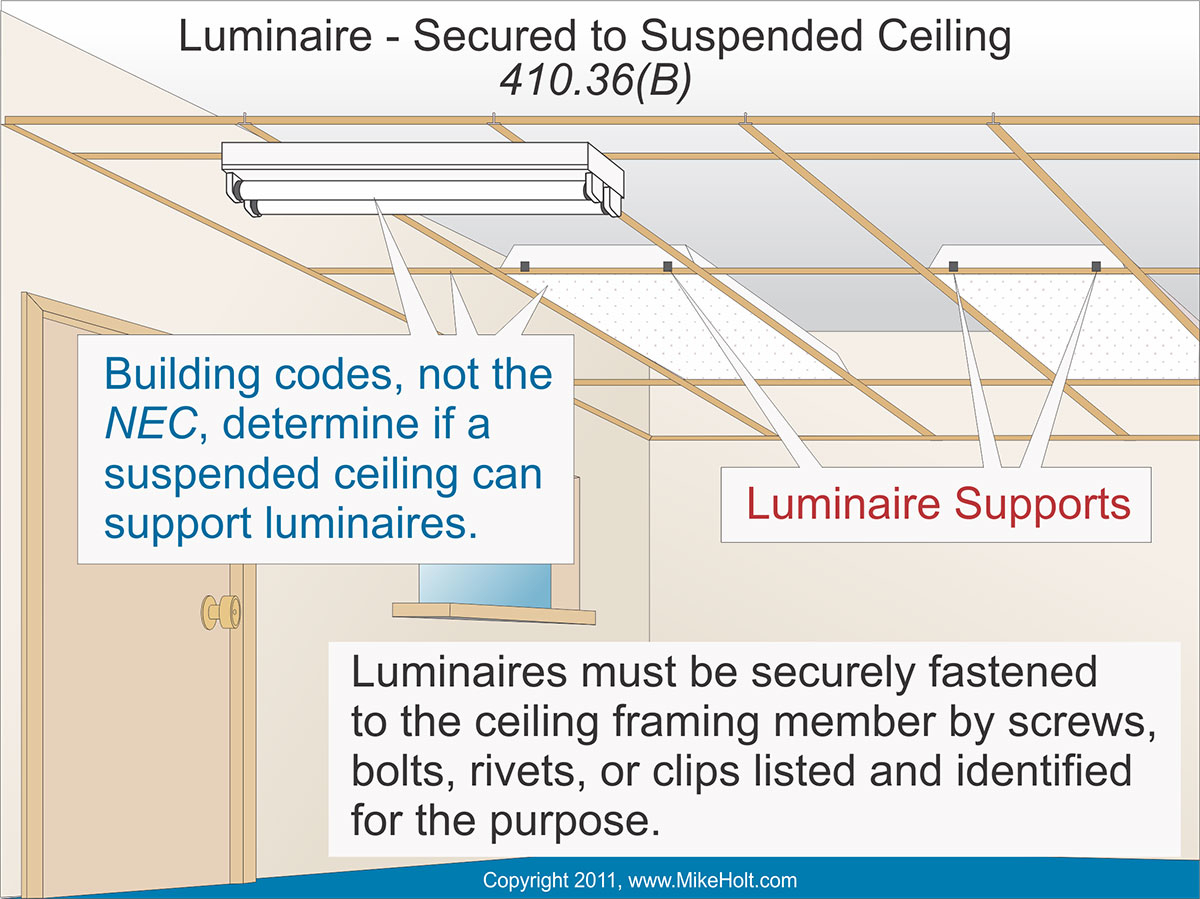

• Secured to the structural or supporting elements of a suspended ceiling [314.23(D)].

If framing members of suspended-ceiling systems are used to support luminaires, they must be securely fastened to each other, and they must be securely attached to the building structure at appropriate intervals. Luminaires must be attached to the suspended-ceiling framing members with screws, bolts, rivets, or clips that are listed and identified for such use [410.36(B)] (see Figure).
Note: The NEC doesn’t require independent support wires for suspended-ceiling luminaires that aren’t installed in a fire-rated ceiling; however, building codes often do. In addition, raceways and cables within a suspended ceiling must be supported in accordance with 300.11(A). Outlet boxes can be secured to the ceiling-framing members by bolts, screws, rivets, clips, or independent support wires that are taut and secured at both ends [314.23(D)].
