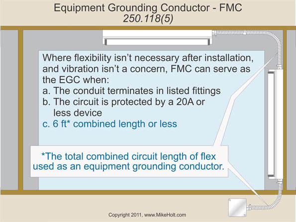

Q. When can flexible metallic conduit serve as an equipment grounding conductor?
A. Listed flexible metal conduit (FMC) can serve as an equipment grounding conductor where [250.118(5)]:
a) The raceway terminates in listed fittings.
b) The circuit conductors are protected by an overcurrent device rated 20A or less.
c) The combined length of the flexible conduit in the same ground fault current path doesn’t exceed 6 ft (Figure).
Flexible metal conduit can be used as an equipment grounding conductor if several criteria are met.
d) If flexibility is required to minimize the transmission of vibration from equipment or to provide flexibility for equipment that requires movement after installation, an equipment grounding conductor of the wire type must be installed with the circuit conductors per 250.102(E), and it must be sized in accordance with 250.122, based on the rating of the circuit overcurrent device.
Informational Note: The equipment grounding conductor is intended to serve as the effective ground fault current path. See Sec. 250.2.
The effective ground fault path is an intentionally constructed low-impedance conductive path designed to carry fault current from the point of a ground fault on a wiring system to the electrical supply source. Its purpose is to quickly remove dangerous voltage from a ground fault by opening the circuit overcurrent device [250.2].
