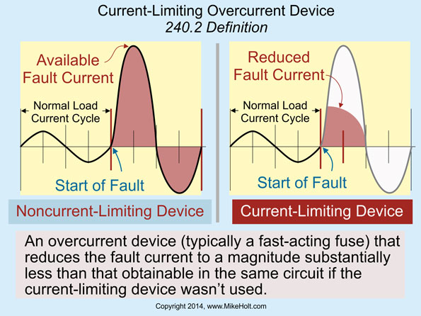

240.1 Informational Note: An overcurrent device protects the circuit by opening the device when the current reaches a value that’ll cause excessive or dangerous temperature rise (overheating) in conductors. Overcurrent devices must have an interrupting rating sufficient for the maximum possible fault current available on the line-side terminals of the equipment [110.9] (Figure). Electrical equipment must have a short-circuit current rating that permits the circuit’s overcurrent device to clear short circuits or ground faults without extensive damage to the circuit’s electrical components [110.10].
