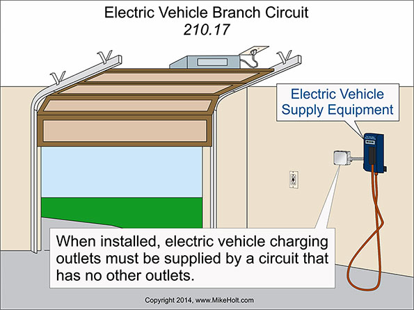

Q. What is the Code requirement for outlets that supply electric vehicle chargers?
Find the Answer
A. This answer is pretty simple and straightforward. Electric vehicle charging outlets must be supplied by a circuit that has no other outlets [Sec. 210.17]. See Sec. 625.2 for the definition of “Electrical Vehicle.”
