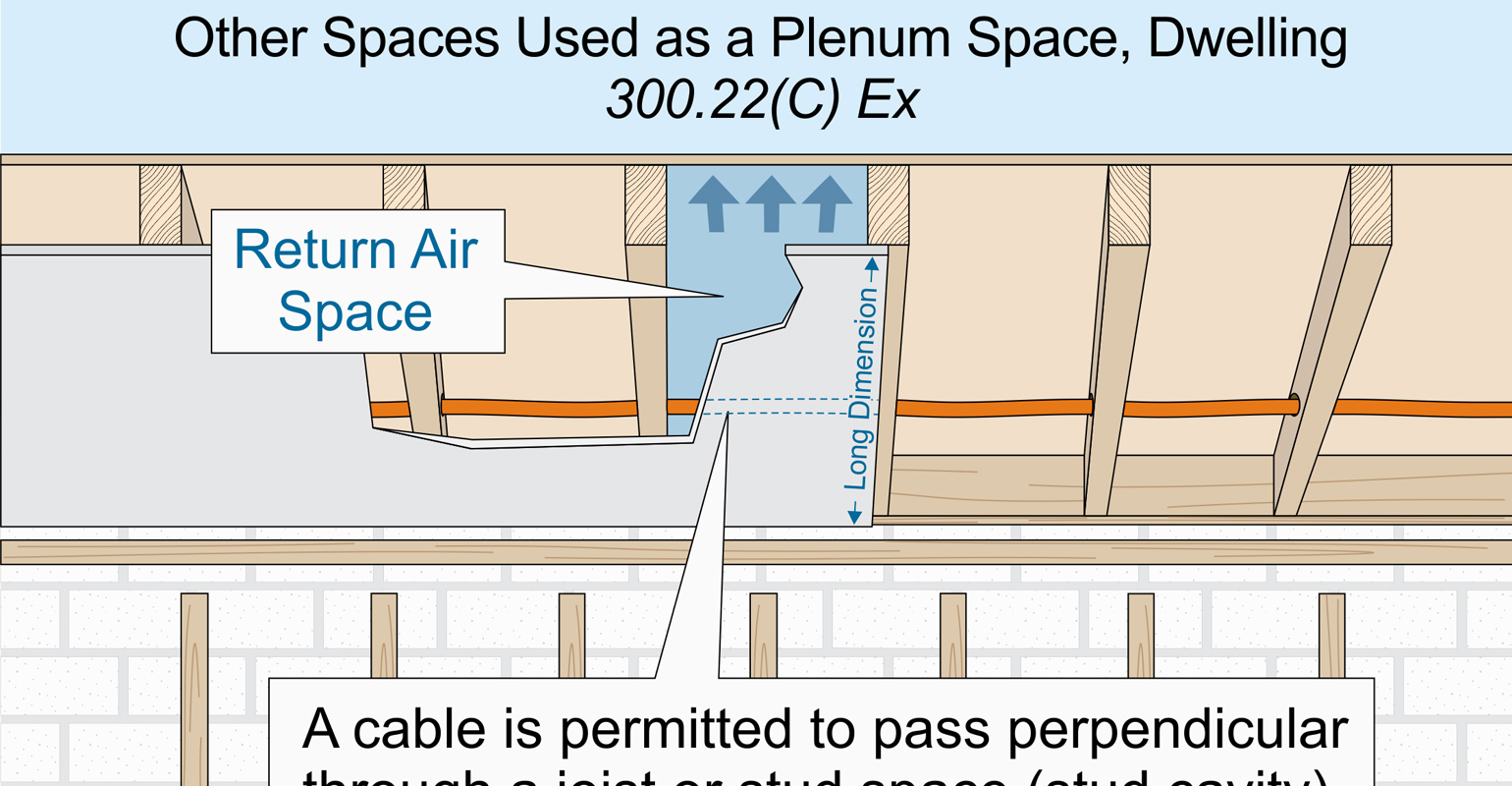

Q. What are the Code rules regarding wiring installed in plenum spaces, such as above suspended ceilings or below a raised floor used for environmental air?
A. Section 300.22(C) applies to spaces not specifically fabricated for environmental air-handling but used for air-handling as a plenum (for example, the space above a suspended ceiling or below a raised floor used for environmental air). It does not apply to habitable rooms or areas of buildings, the prime purpose of which is not air handling.
Informational Note 1: The space or cavity above a suspended ceiling or below a raised floor used for environmental air are examples of the type of plenum space to which this Section applies.
Exception: In a dwelling unit, this section of the Code doesn’t apply to the space between joists or studs where the wiring passes through that space perpendicular to the long dimension of that space (Fig. 1).
Wiring methods permitted in plenum spaces include electrical metallic tubing (EMT), rigid metal conduit (RMC), intermediate metal conduit (IMC), armored cable, metal-clad cable (MC cable) without a nonmetallic cover, and flexible metal conduit (FMC). Surface metal raceways or metal wireways with metal covers can also be installed in a plenum space [300.22(C)(1)].
Cable ties for securing and supporting must be listed for use in a plenum space.
PVC conduit [Art. 352], electrical nonmetallic tubing (ENT) [Art. 362], liquidtight flexible conduit (LFC), and nonmetallic cables aren’t permitted to be installed in plenum spaces because they give off deadly toxic fumes when burned or superheated.
