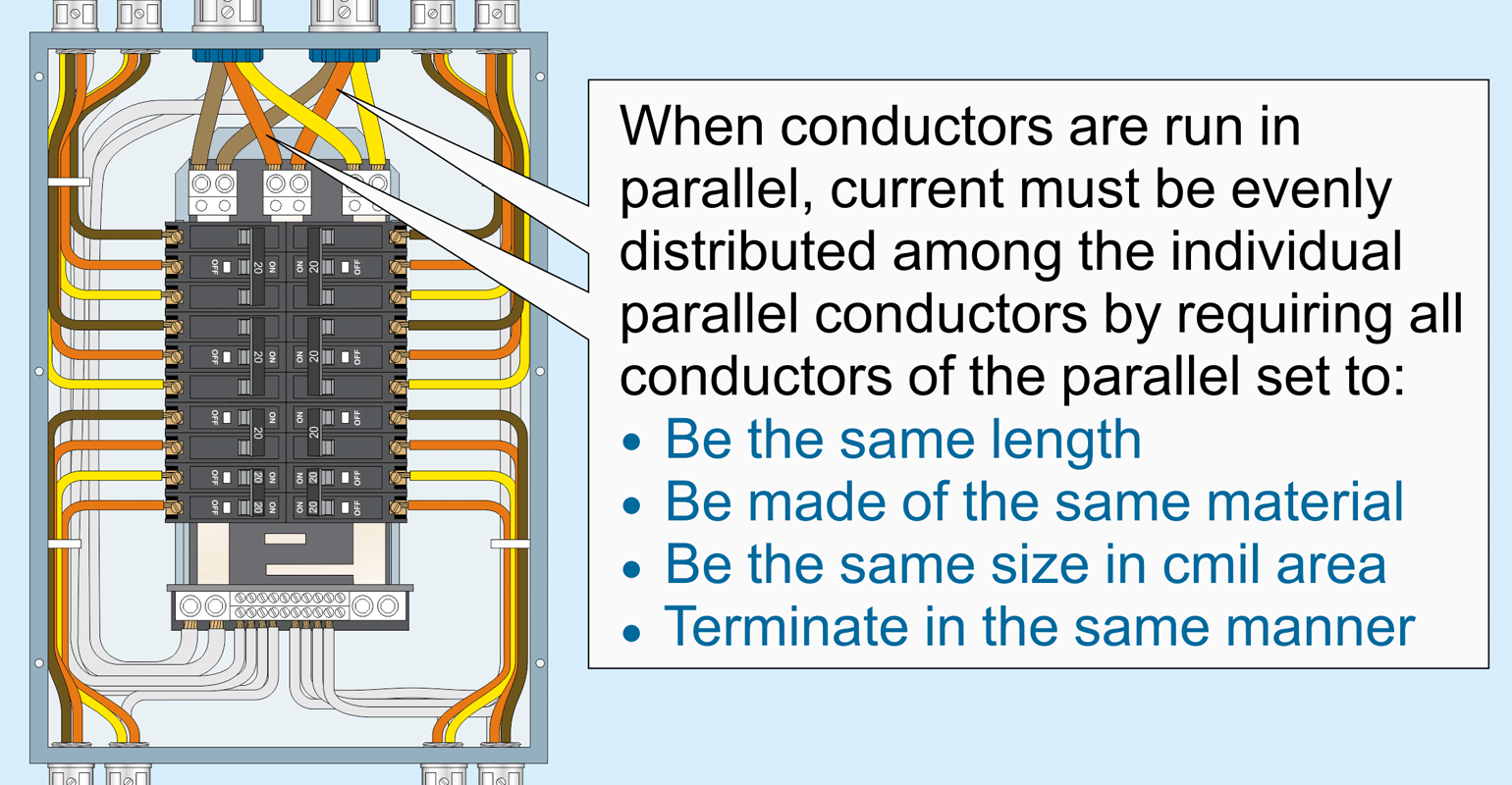

Q. When conductors are installed in parallel, what does the Code require regarding the conductor and installation characteristics?
A. When circuit conductors are installed in parallel, the conductors must be connected so the current will be evenly distributed between the individual parallel conductors by requiring all circuit conductors within each parallel set to [Sec. 310.10(H)(2)] (see Figure):
(1) Be the same length.
(2) Consist of the same conductor material (copper/aluminum).
(3) Be the same size in circular mil area (minimum 1/0 AWG).
(4) Have the same type of insulation (like THHN).
(5) Terminate using the same method (set screw fitting versus compression fitting).
When installed in raceways, parallel circuit conductors must be grouped together in each raceway. This means each raceway of a parallel set must include a phase A, B, and C, the neutral (if used), and the equipment grounding conductor (if used). If all phase A’s are grouped in one raceway, all phase B’s in another raceway, and all phase C’s in another raceway, the magnetic fields surrounding the conductors won’t be able to cancel each other out, causing inductive heating in violation of Sec. 300.20.
