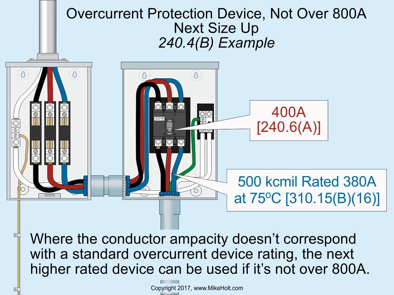

Q. Does the NEC allow overcurrent protection for conductors to be rounded up to the next larger size?
See the answer below.
A. Absolutely! The next higher standard rating of overcurrent protection device listed in Sec. 240.6 (above the ampacity of the ungrounded conductors being protected) is permitted, provided all of the following conditions are met [Sec. 240.4(B)]:
(1) The conductors aren’t part of a branch circuit supplying more than one receptacle for cord-and-plug-connected loads.
(2) The ampacity of a conductor, after the application of ambient temperature correction [Sec. 310.15(B)(2)(a)], conductor bundling adjustment [Sec. 310.15(B)(3)(a)], or both, doesn’t correspond with the standard rating of a fuse or circuit breaker in Sec. 240.6(A).
(3) The overcurrent protection device rating doesn’t exceed 800A.
