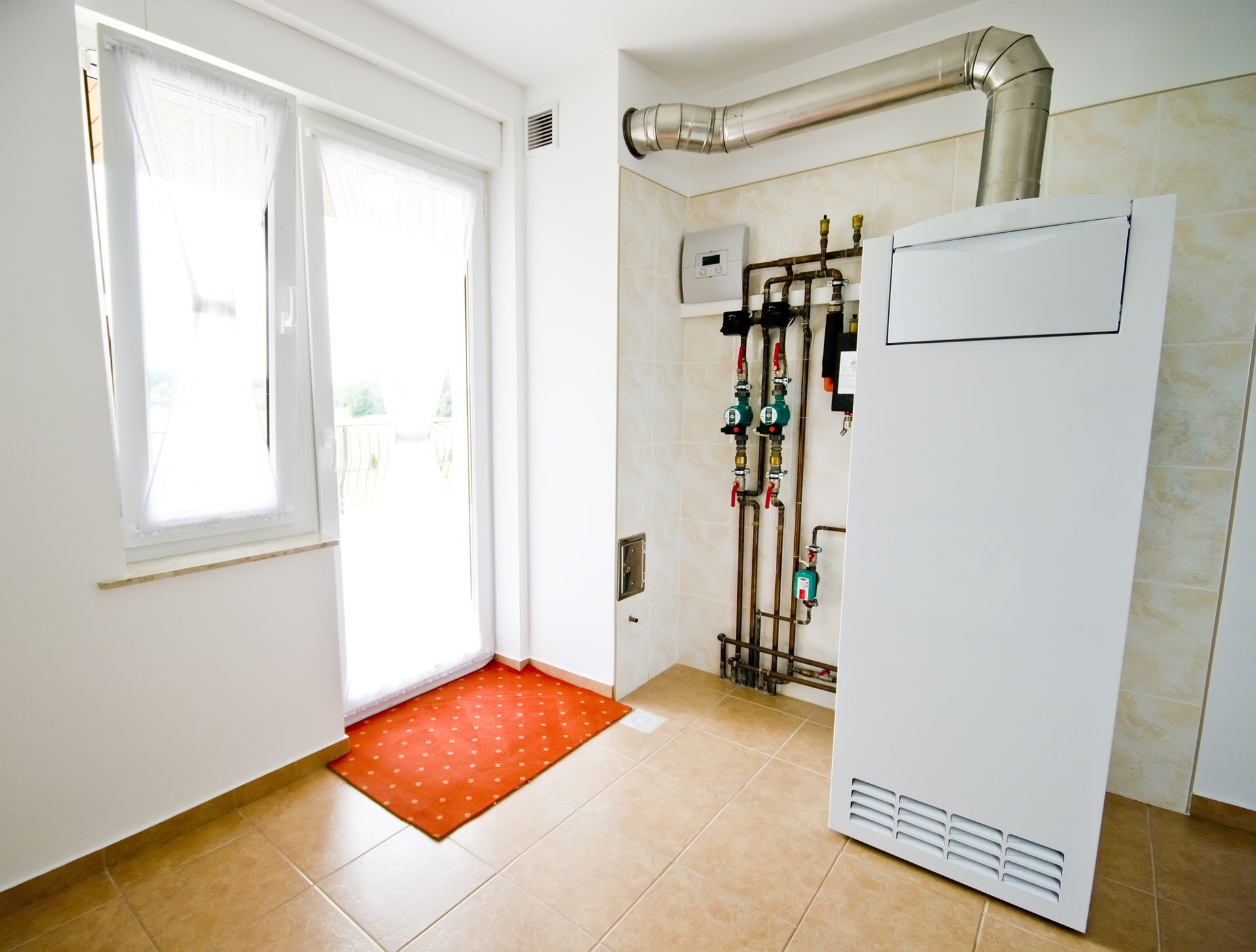

Q. What are the NEC branch circuit requirements for central heating equipment such as furnaces?
See the answer below.
A. An individual branch circuit must supply central heating equipment, such as gas, oil, or coal furnaces [Sec. 422.12].
Exception No. 1: Auxiliary equipment to the central heating equipment, such as pumps, valves, humidifiers, and electrostatic air cleaners, can be connected to the central heater circuit.
Exception No. 2: Permanently connected air-conditioning equipment can be connected to the individual branch circuit that supplies central heating equipment.
This rule isn’t intended to apply to a listed wood-burning fireplace with a fan, since the fireplace isn’t central heating equipment.
Electric space-heating equipment must be installed in accordance with Article 424—Electric Space-Heating Equipment.
