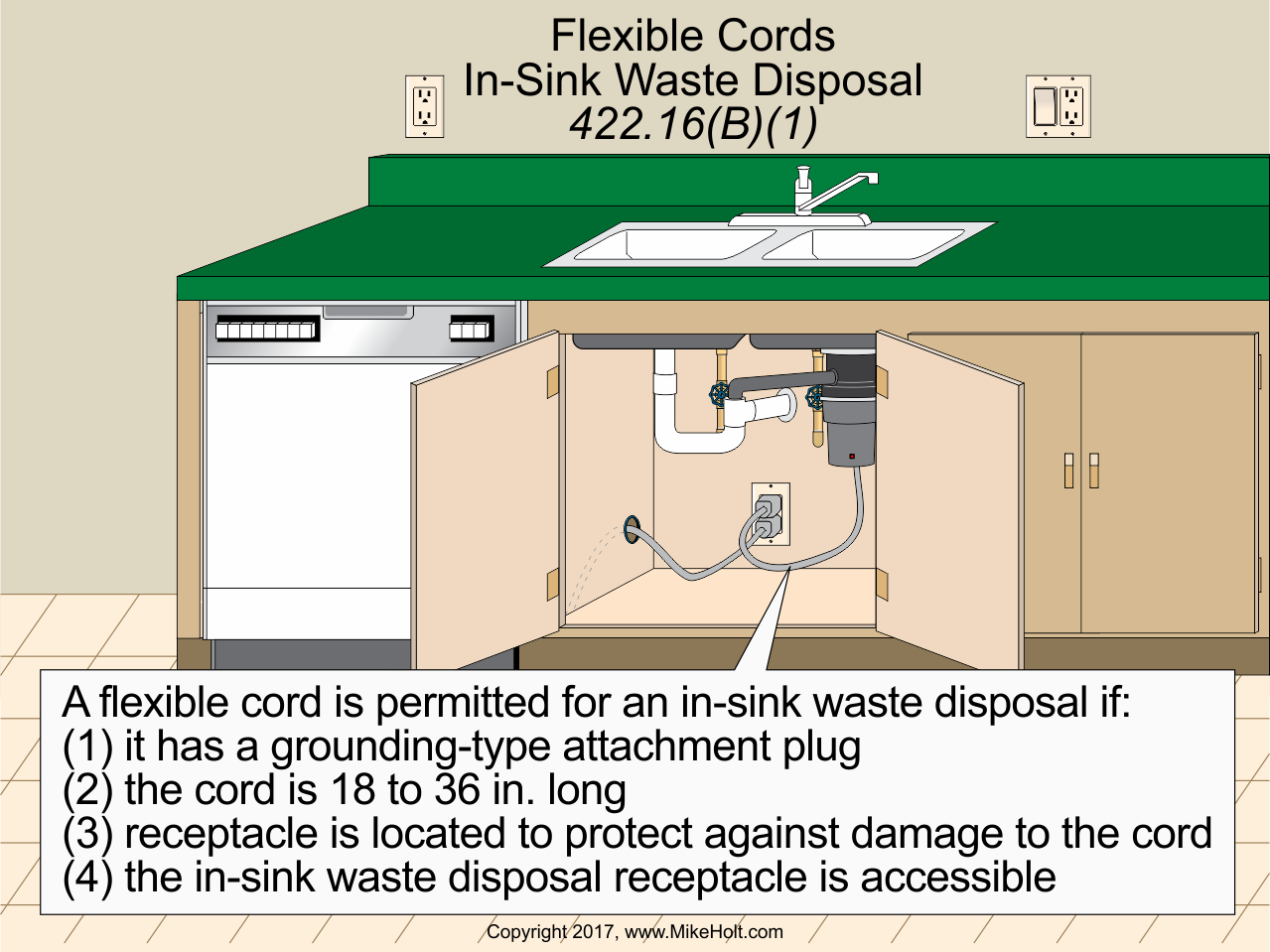

Q. What are the Code rules for the connection of in-sink waste disposal units when using a flexible cord?
See answer below.
A. As outlined in Sec. 422.16(B)(1), a flexible cord is permitted for an in-sink waste disposal unit if:
(1) The flexible cord has a grounding‑type attachment plug. Exception: A listed in‑sink waste disposal marked as protected by a system of double insulation isn’t required to be terminated with a grounding‑type attachment plug.
(2) The flexible cord length is at least 18 in. in length and no longer than 3 ft.
(3) The receptacle must be located so as to protect against damage to the flexible cord.
(4) The receptacle is accessible.
