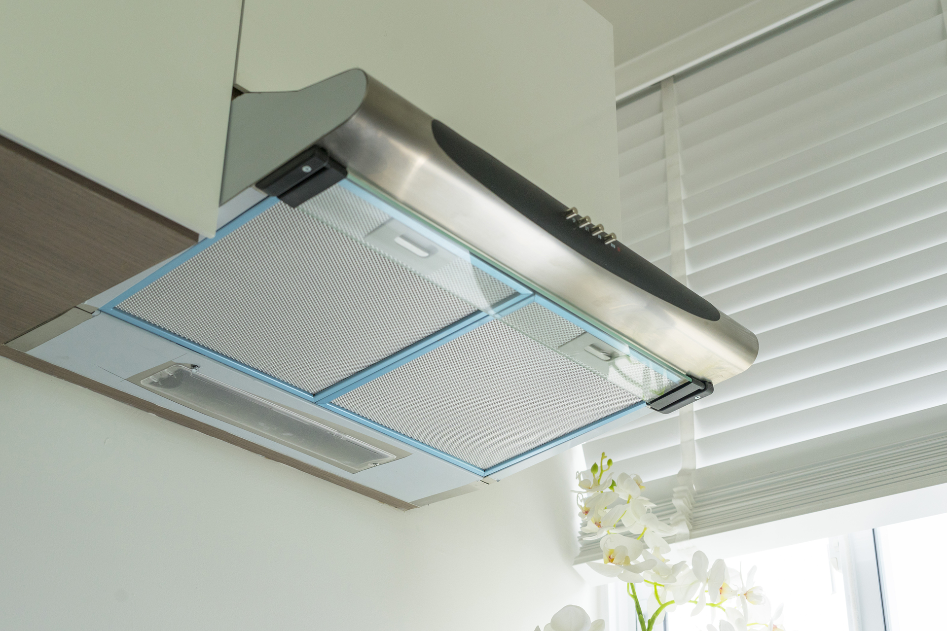

Q. What are the Code rules for the connection of range hoods by means of flexible cords?
See answer below.
A. As noted in Sec. 422.16(B)(4), range hoods can be cord-and-plug‑connected if all of the following conditions are met:
(1) The flexible cord for the range hood terminates with a grounding-type attachment plug. Exception: A listed range hood marked as protected by a system of double insulation is not required to be terminated with a grounding‑type attachment plug.
(2) The length of the flexible cord for the range hood is not permitted to be less than 18 in. or longer than 48 in.
(3) The receptacle for the range hood must be located to protect against physical damage to the flexible cord.
(4) The range hood receptacle must be accessible.
(5) The range hood receptacle must be supplied by an individual branch circuit.
