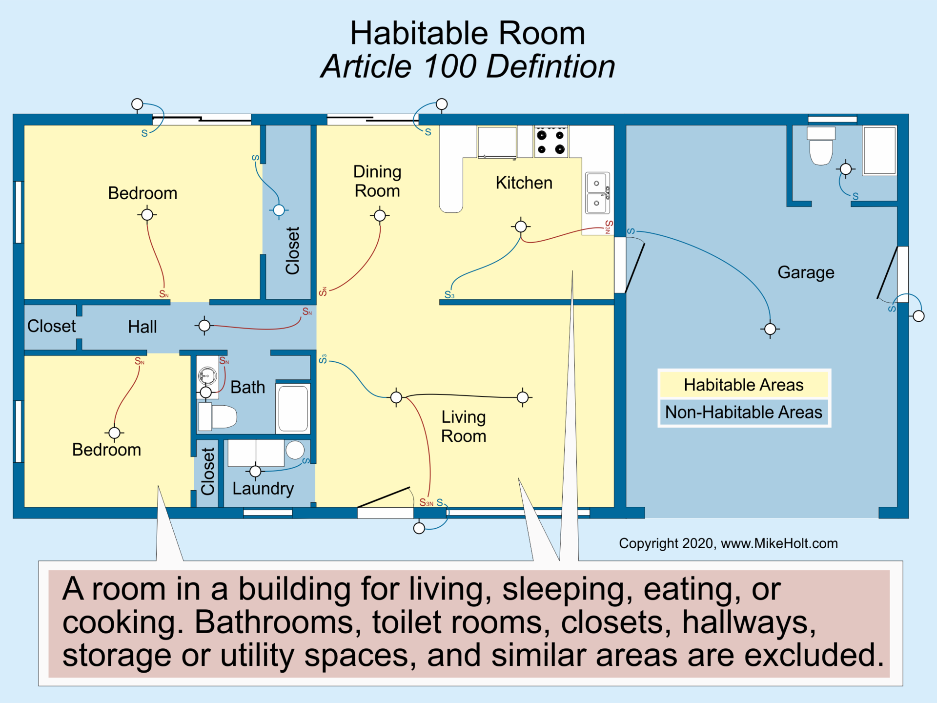

    Q. How is a habitable room defined in the Code?
    See answer below.
    A. Habitable Room. A room in a building for living, sleeping, eating, or cooking, but excluding bathrooms, toilet rooms, closets, hallways, storage or utility spaces, and similar areas [Art. 100 Definitions].
