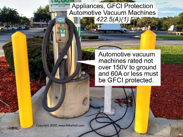

Q. What are the NEC requirements for GFCI protection of appliances?
A. The following appliances rated 150 volts-to-ground or less and 60A or less must be GFCI-protected by Class “A” protective device(s) [Sec. 422.5(A)]:
(1) automotive vacuum machines (Fig. 1),
(2) drinking water coolers and bottle fill stations,
(3) cord- and plug-connected high-pressure spray washing machines,
(4) tire inflation machines,
(5) vending machines,
(6) sump pumps, and
(7) dishwashers.
