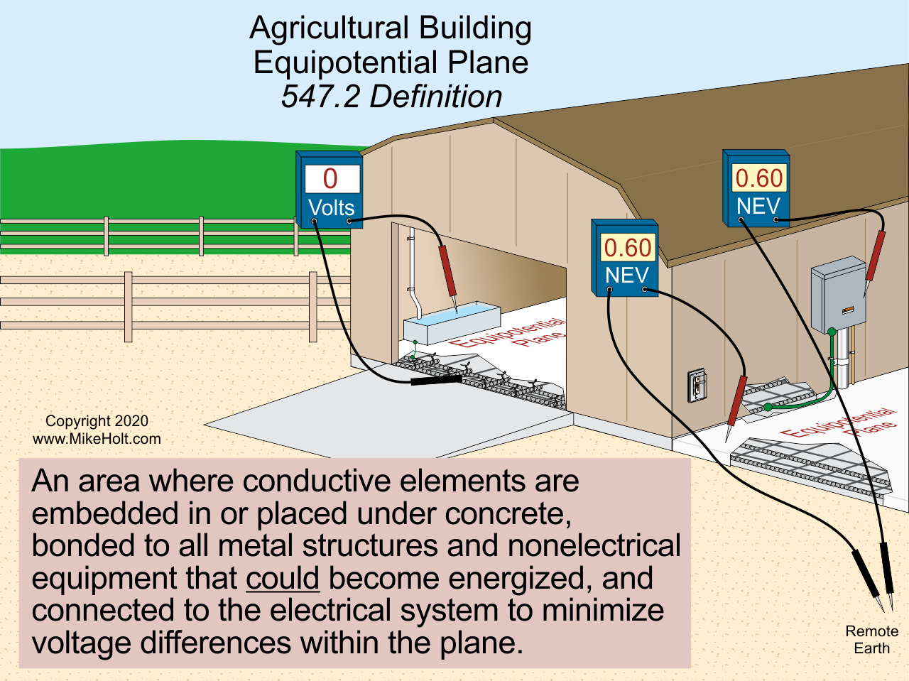

Q. What is the Code definition of equipotential plane as applied to agricultural buildings?
A. Equipotential Plane, (as applied to agricultural buildings), is defined as an area where conductive elements are embedded in or placed under concrete and bonded to all metal structures and nonelectrical equipment that could become energized and connected to the electrical system to minimize voltage differences within the plane [Sec. 547.2], as shown in the Figure.
