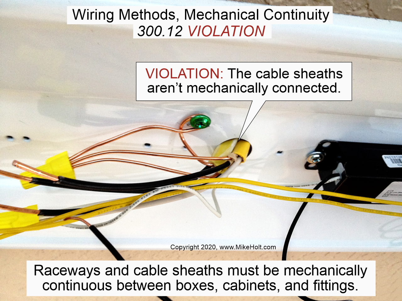

Q. What are the rules for the mechanical continuity of raceways and cable sheaths?
See answer below.
A. As noted in Sec. 300.12, raceways and cable sheaths must be mechanically continuous between boxes, cabinets, and fittings.
Exception No. 1: Short sections of raceways used to provide support or protection of cables from physical damage are not required to be mechanically continuous (Sec. 250.86 Exception No. 2 and Sec. 300.10 Exception No. 1).
Exception No. 2: Raceways and cables installed into the bottom of open-bottom equipment such as switchboards, motor control centers, and floor or pad-mounted transformers are not required to be mechanically secured to the equipment.
