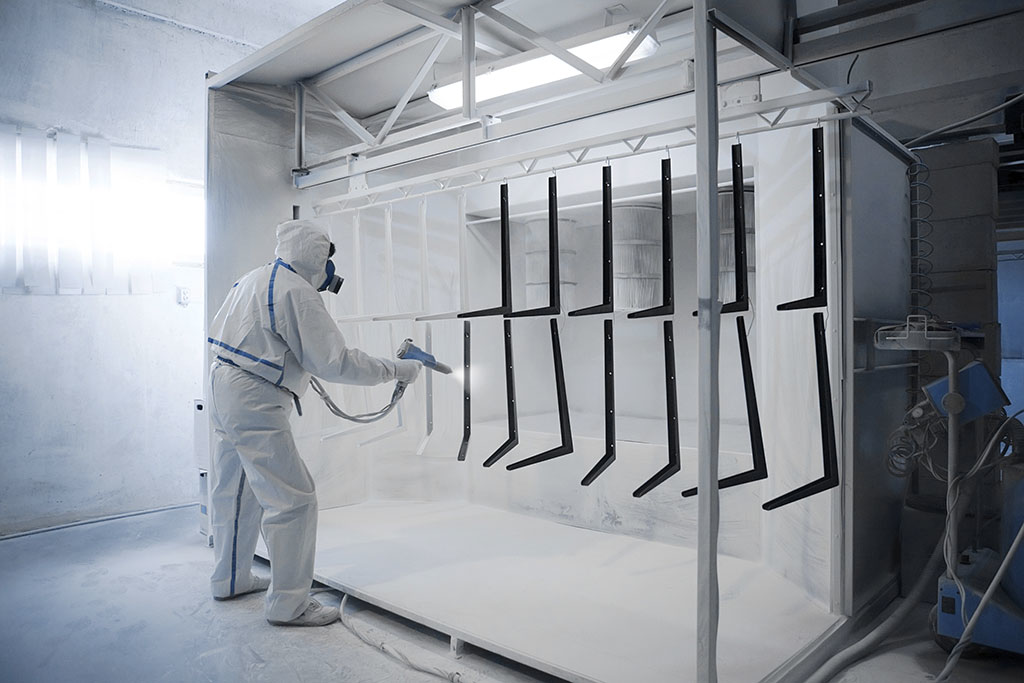

In spray applications, as per Art. 516, the handle of the spraying gun shall be constructed so that the operator, in normal operating position, is in direct electrical contact with the grounded handle — with a resistance of not more than  ___ megohm — to prevent buildup of a static charge on their body.

As noted in Sec. 516.10(B)(3) [Handle], “The handle of the spraying gun shall be electrically connected to ground by a conductive material and be constructed so that the operator in normal operating position is in direct electrical contact with the grounded handle with a resistance of not more than 1.0 megohm to prevent buildup of a static charge on the operator’s body.”
