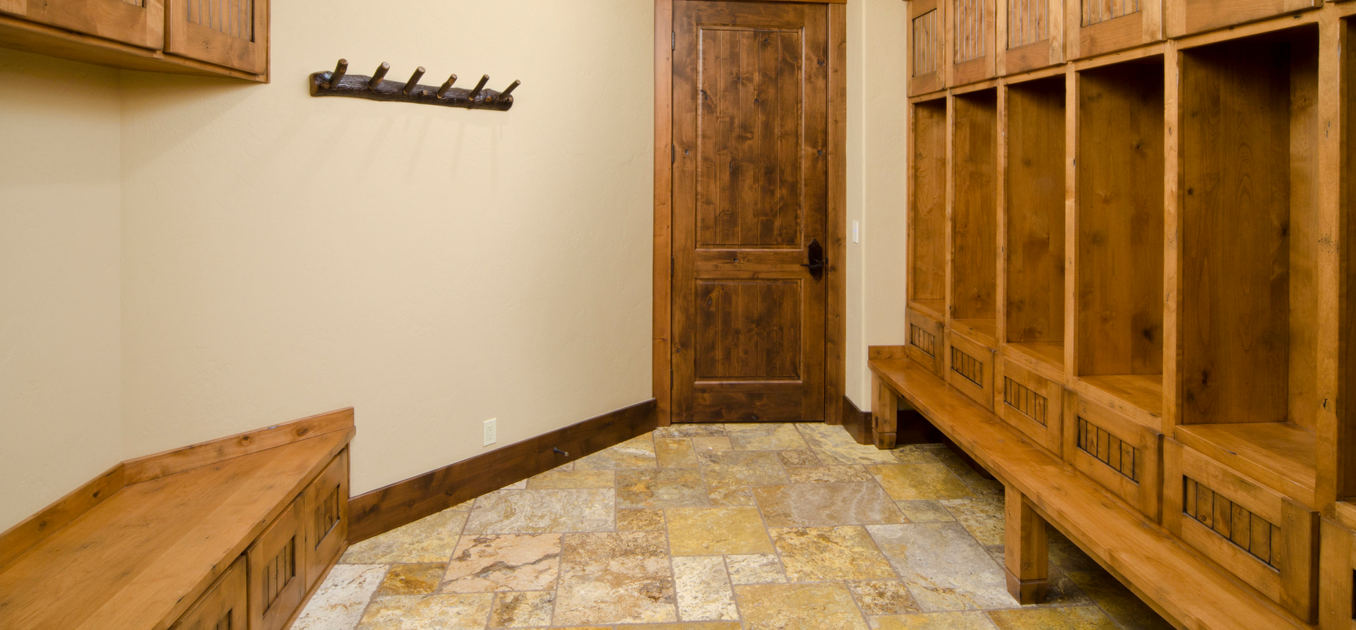

Question: Receptacles in a dwelling unit mud room with a tile floor require GFCI protection.
See the answer below.
Answer: True
Explanation: A new location was added to the list in Sec. 201.8 (item 11). GFCI protection is now required in indoor damp and wet locations. This will likely be up to the interpretation of the AHJ when determining if the mud room is a damp or wet location.
