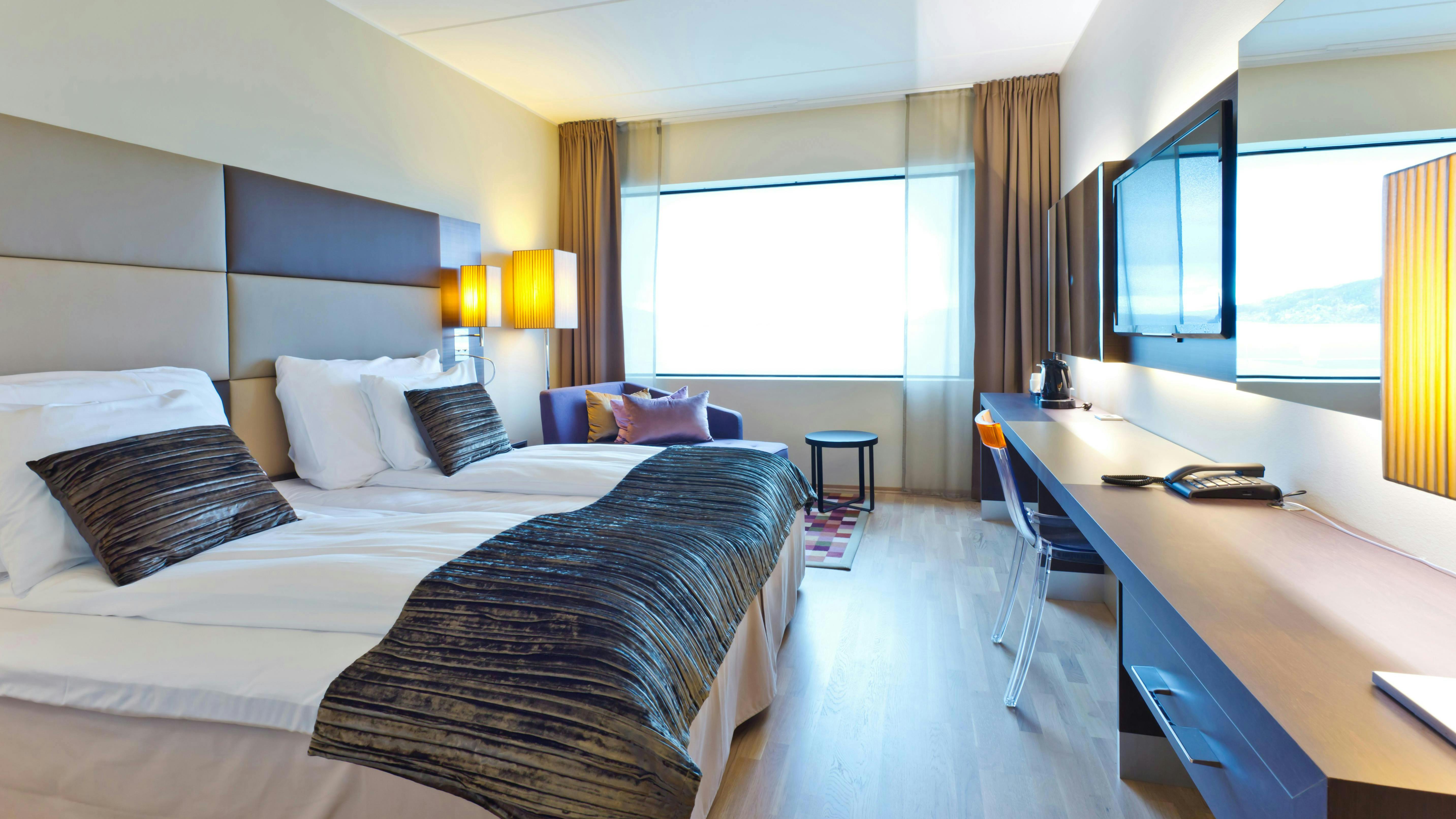

Q1: The number of receptacle outlets for guest rooms in hotels and motels shall not be less than that required for a dwelling unit. These receptacles shall be located to be convenient for permanent furniture layout, but at least _____ receptacle outlet(s) shall be readily accessible.
a) one
b) two
c) three
d) four

Q1: b) two
As stated in Sec. 210.60(B), "At least two receptacle outlets shall be readily accessible."
