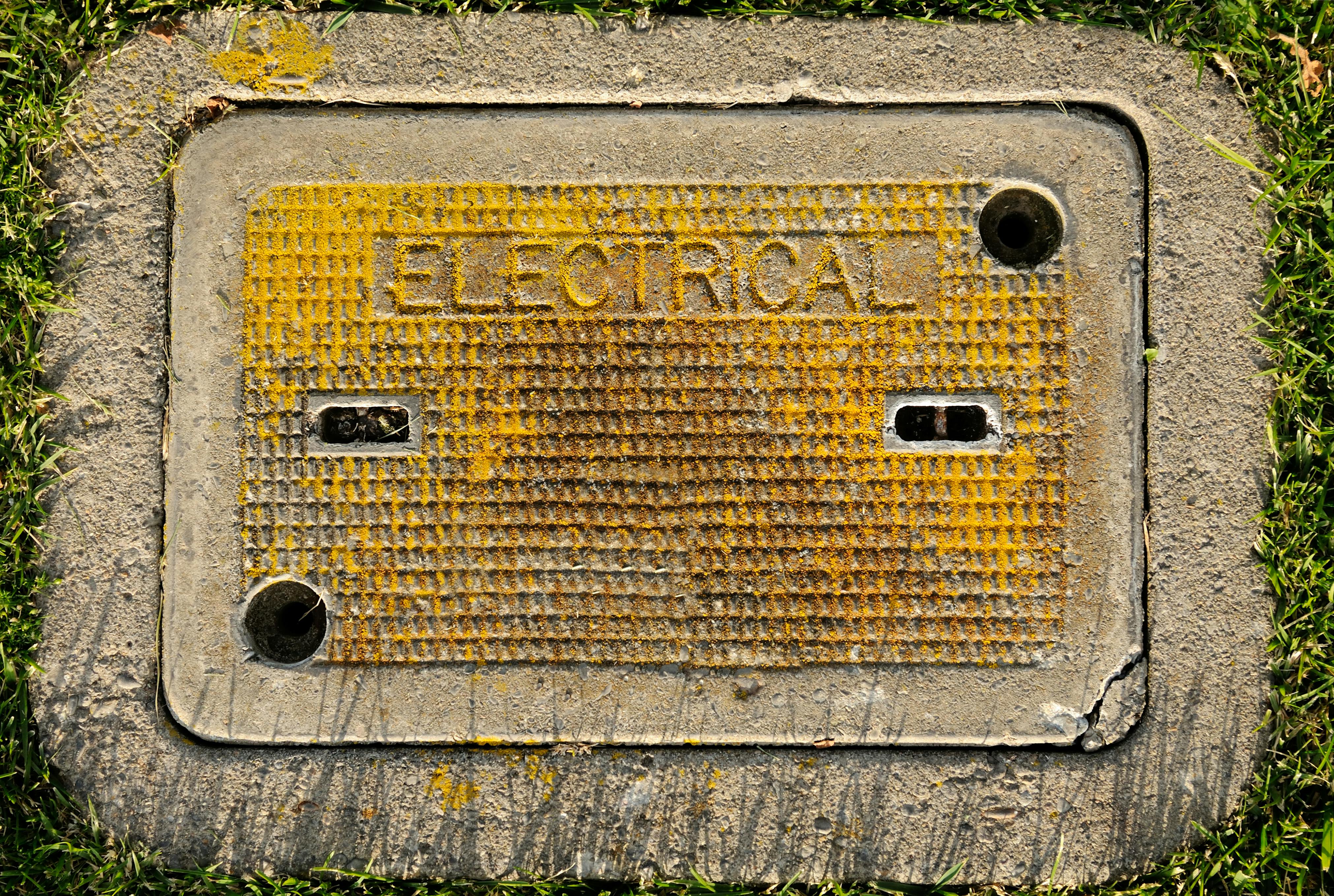

Q1: Underground _____ shall be installed so they are accessible without excavating sidewalks, paving, earth, or other substance that is to be used to establish the finished grade.
a) boxes and handhole enclosures
b) conduit bodies
c) handhole enclosures
d) none of these

Q1: a) boxes and handhole enclosures
Section 314.29(B) states, "Underground boxes and handhole enclosures shall be installed so they are accessible without excavating sidewalks, paving, earth, or other substance that is to be used to establish the finished grade."
