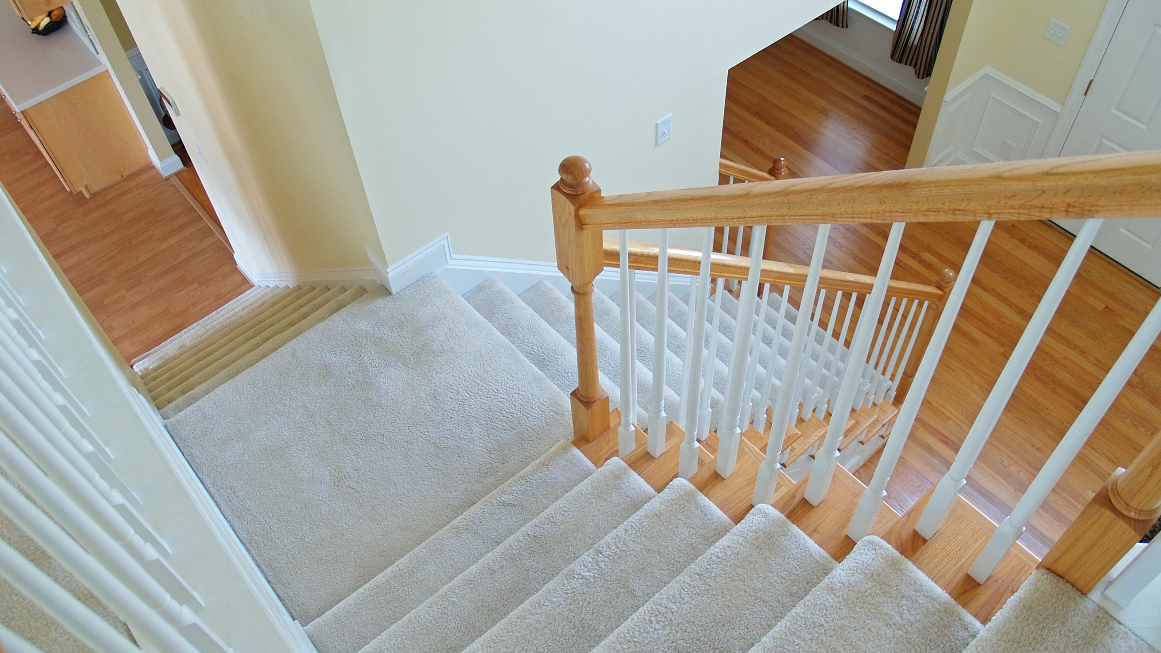

Q1: Where lighting outlets are installed for an interior stairway with _____ risers between floor levels, there shall be a listed wall-mounted control device at each floor level and at each landing level that includes a stairway entry to control the lighting outlets.
a) three or more
b) four or more
c) six or more
d) any number of

Q1: c) six or more
Section 210.70(A)(2)(3) requires, "Where lighting outlets are installed for an interior stairway with six or more risers between floor levels, there shall be a wall switch or listed wall-mounted control device at each floor level and at each landing level that includes a stairway entry to control the lighting outlets."
