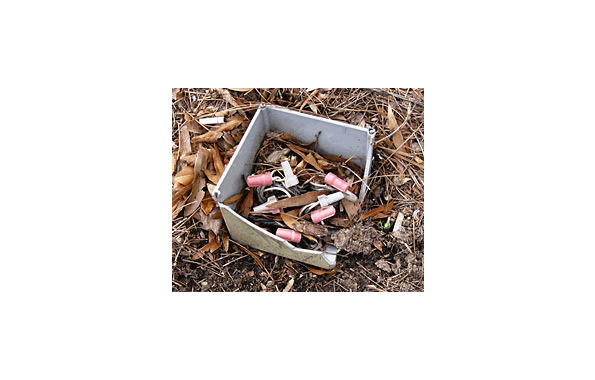

Hit and Run
This hit and run victim revealed itself after some spring cleaning was performed by a landscape crew. Unfortunately, this exposed splice box looks like it has been this way for quite a long time. The circuits were energized and serve year-round tree lighting and receptacles throughout the parking lot.
Although this type of box is permitted for outdoor locations, it has been installed much too close to this low curb edge. As such, vehicle tires have more than likely made contact with this on more than one occasion. The installer should have located this box in a better protected location.
One section of the Code comes to mind when reviewing this installation. As noted in 314.29, “Boxes, conduit bodies, and handhole enclosures shall be installed so that the wiring contained in them can be rendered accessible without removing any part of the building or, in underground circuits, without excavating sidewalks, paving, earth, or other substance that is to be used to establish the finished grade.” An Exception to this requirement states, “Listed boxes and handhole enclosures shall be permitted where covered by gravel, light aggregate, or non-cohesive granulated soil if their location is effectively identified and accessible for excavation.”
