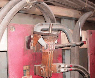

Clamped Destruction
Unfortunately, this isn’t the first time we’ve seen an installation like this. It’s seems obvious that whoever installed this clamp did so to keep the tabs squeezed tight enough to hold the switch blades in place. I think a review of Sec. 110.3 of the 2011 NEC is in order.
More specifically, 110.3(A) states: “In judging equipment, considerations such as the following shall be evaluated:
  1. Suitability for installation and use in conformity with the provisions of this Code.
  2. Mechanical strength and durability, including, for parts designed to enclose and protect other equipment, the adequacy of the protection thus provided.
  3. Wire-bending and connection space.
  4. Electrical insulation.
  5. Heating effects under normal conditions of use and also under abnormal conditions likely to arise in service.
  6. Arcing effects.
  7. Classification by type, size, voltage, current capacity, and specific use.
  8. Other factors that contribute to the practical safeguarding of persons using or likely to come in contact with the equipment.”
I think all of these references apply to this situation.
