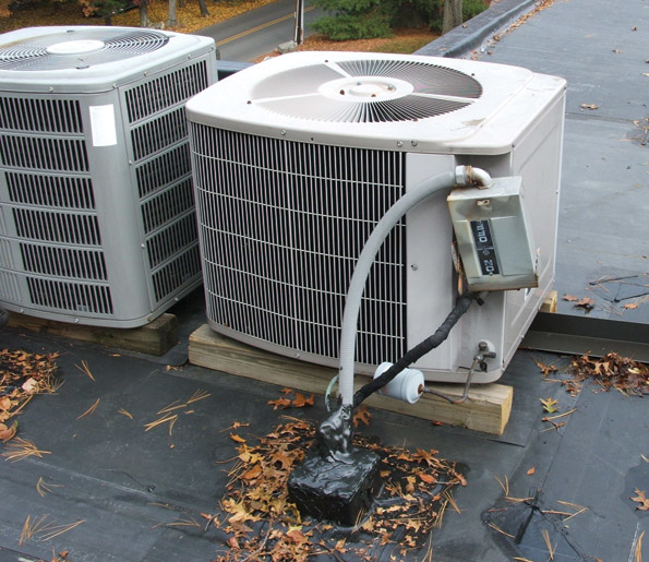

Which Way is Up?
This weatherproof disconnect is not so weatherproof when it’s installed upside down! Section 404.4 requires a surface-mounted switch to be enclosed in a weatherproof enclosure or cabinet. While this general-use switch is a weatherproof-type unit, it is certainly not installed properly.  Section 312.2 requires surface-type enclosures to be placed or equipped so as to prevent moisture or water from entering and accumulating within the enclosure. They are also required to be placed so there is at least a ¼-in. airspace between the enclosure and the supporting surface. Enclosures in wet locations shall be weatherproof, and raceways or cables entering above the level of uninsulated energized parts shall use fittings that are listed for wet locations. Also, Section 404.7 requires general use switches to clearly indicate whether they are in the “off” or “on” position. Switch or circuit breaker handles that operate vertically, shall be installed so that the “up” position of the handle is the “on” position. For this switch, “up” is “off” and “down” is “on.” This could cause confusion and create a hazard if a person were to only notice the handle position.
