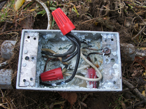

    Wet and Wild!
    I discovered this buried aluminum box full of moisture when I removed its cover. The trapped moisture had caused severe corrosion to the box as well as the wiring, which arced and tripped the circuit breaker.
    Section 314.15 requires boxes, conduit bodies, and fittings to “be placed or equipped so as to prevent moisture from entering or accumulating within the box, conduit body, or fitting.”Clearly, that did not happen here, and the result was a gooey mess of corrosion. In addition, the twist-on wire connectors used in this box were not specifically designed for use in a wet location. According to Sec. 300.5(B), “any connections or splices in an underground installation shall be approved for wet locations.”
    Lastly, Sec. 300.6(B) requires installers to provide supplementary corrosion protection for “aluminum raceways, cable trays, cablebus, auxiliary gutters, cable armor, boxes, cable sheathing, cabinets, elbows, couplings, nipples, fittings, supports, and support hardware embedded or encased in concrete or in direct contact with the earth.”
    The installer should have installed a small, nonmetallic handhole in place of the aluminum box and used wet location-rated twist-on wire connectors.
