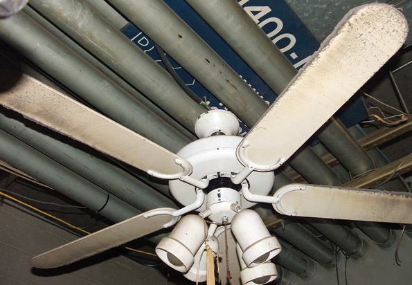

A Photo From My Fan Club
This floppy paddle fan was installed without any box. Instead, the installer used toggle bolts to secure the mounting bracket directly to a real estate sign precariously positioned above those 4-in. raceways. No wonder the maintenance manager called to complain that his fan was “wobbling like crazy!”
The fan was wired with SJO type cord, which was simply thrown over the top of the raceways and then connected to a surface-mounted switch box on the wall. Using flexible cord in this manner is a violation of 400.8(1), which does not permit flexible cords to be used as a substitute for a fixed wiring method.
The installer also violated the intent of 422.18, which requires ceiling-suspended paddle fans to be supported independently of an outlet box, or by securing the fan to a listed outlet box identified for the support of paddle fans. Since no box was used for the bracket or to enclose the splices, we could argue that 300.15 has also been violated — because that section of the Code requires a box or conduit body to be installed where splices are made in cable-type wiring methods.
