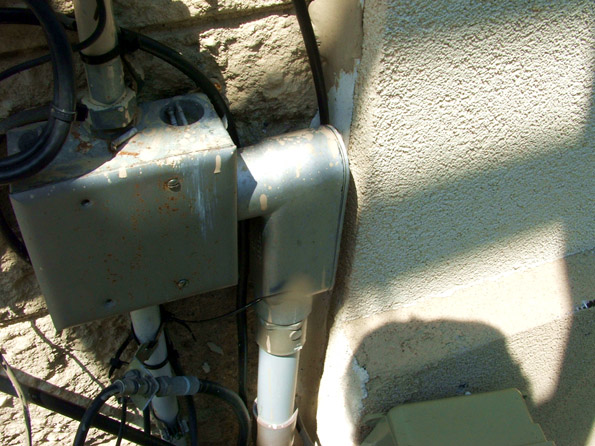

Tight Quarters
There is virtually no way to open and gain access to the wiring inside this LB conduit body. The installer jammed an LB into the corner instead of using a conduit body with a cover on its side, such as an LL or an LR. This lack of access is a violation of Sec. 314.29 of the 2011 NEC. Boxes, handholes, and conduit bodies must be installed so that the wiring inside of them is accessible without having to remove or destroy any part of the building.
Another problem I can point out is the coaxial cables that are tie-wrapped to the outside of the raceways connected to the weatherproof box. This is a violation of 300.11(B) and 820.133(B). Coaxial cables are not permitted to be attached to the exterior of raceways or conduits as a means of support.
Whether proper bonding and grounding techniques were used for the coaxial cable shield is also in doubt. Section 820.100(A)(6) requires the bonding conductor to be protected when exposed to physical damage. As can be seen in the photos, the bonding/grounding conductor for the coaxial cable is just flapping in the breeze — with almost no effort made to protect it.
