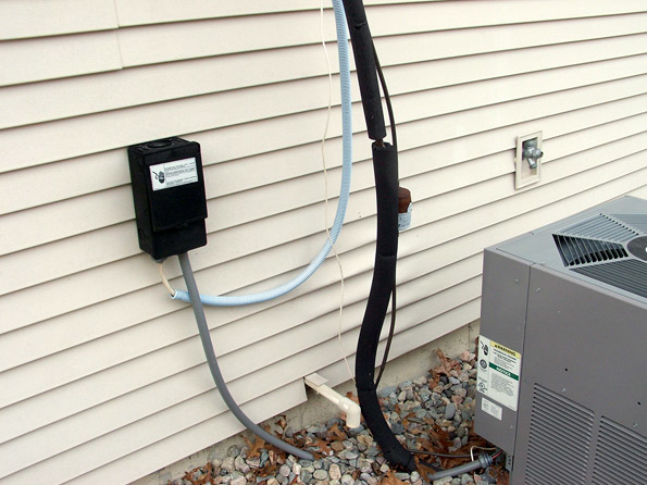

What a Rush!
Apparently, the person who installed the wiring for this air-conditioning  (A/C) unit didn’t know the permitted uses for ENT or NM cable. A quick check of 362.12(8) of the 2011 NEC informs us that ENT is not permitted to be installed where it will be exposed to direct sunlight, unless it is identified as sunlight-resistant. Upon close investigation, I did not find any markings or labels on the ENT to indicate that it was suitable for direct sunlight.  In addition, the supporting methods for the ENT are questionable, since the raceway is attached with cable ties to the refrigerant lines instead of being securely fastened to the structure as intended by 362.30(A). If you take a closer look, you’ll see the ENT has been used as a sleeve for NM cable. This is a clear violation of 334.12(B)(4), because NM cable is not permitted to be used in wet locations. According to 300.9, the interior of this aboveground raceway is considered a wet location. Upon even closer examination, we can see the LFMC from the disconnect is not properly supported either. The end near the A/C unit is dangling in the air and not even connected to the unit.
