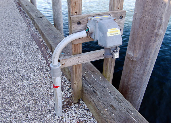

Someone Really Missed the Boat
Section 555.13(A)(1) permits the use of PVC as a wiring method for marinas and boatyards; however, the PVC supplying this shore power receptacle is snapped off at the connector, leaving the damaged conductors exposed. This was because the installer did not anticipate the movement of the dock area and PVC coming out of the ground. Section 300.5(J) requires direct buried raceways, cables, and conductors subject to movement from settling or frost heaves to be arranged so that the movement does not cause damage to the conductors or the equipment connected to the raceways. The use of an expansion joint or flexible wiring methods may have prevented this breakage from happening in the first place. Because this PVC is exposed and installed in an area where it is subject to physical damage, Sec. 352.12(C) requires the use of thicker walled Schedule 80 PVC instead of the thinner walled Schedule 40 PVC. Section 555.17 requires a disconnecting means of the switch or circuit breaker type for this receptacle to be readily accessible and located within 30 in. of the receptacle. There was no disconnect to be found anywhere in sight. All in all, this installation leaves me feeling a little sea sick.
