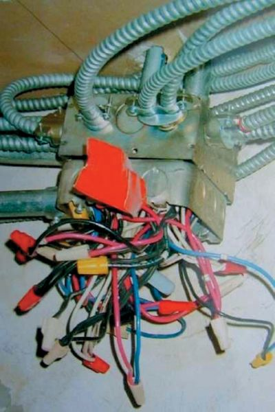

    A smaller sized extension ring was installed on a larger sized metal box to gain more space for numerous No. 12 AWG circuit conductors. Obviously, the space this ring provided was insufficient for this overcrowded box. Also, the one screw used to attach the smaller ring left the box improperly grounded. In addition, the connectors (some of which were not designed for use with this wiring method) were loose, and it was impossible to put the cover on the box.
    Sec. 300-14 requires at least 6 in. of free conductor, measured from the point in the box where it emerges from its raceway or cable sheath, at each outlet, junction, and switch point for splices or the connection of fixtures or devices. Where the opening to an outlet, junction, or switch point is less than 8 in. (in any dimension), each conductor shall be long enough to extend at least 3 in. outside the opening.
