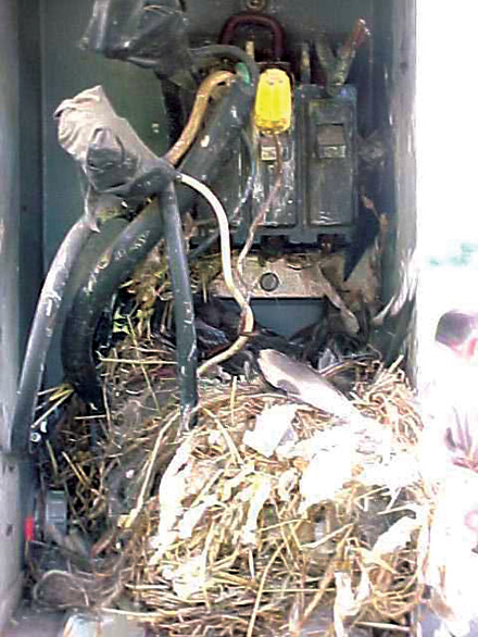

One Hot Nest
All references are based on the 1999 edition of the NEC.
EC&M’s national sales manager, David Miller, took this picture of a load center—complete with bird nest and inhabitants—at a family reunion held in a public park in Somonauk, Ill. He found the box unlocked, opened, and mounted so low on a wooden post supporting the roof of a picnic shelter that small children could reach it. The load center housed breakers for lighting and ceiling fans. This violates rules in Arts. 110 and 404 of the 2002 NEC.
