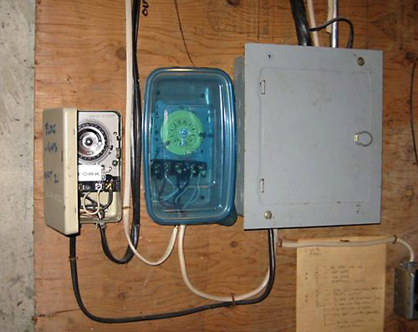

    Keith Budka, president of Budka Electric Corp., Nesconset, N.Y., was amazed to find “a new use for Ziplock containers.” This installation is a clear violation of the Code.
    As per 404.5, “Time switches, flashers, and similar devices shall be of the enclosed type or shall be mounted in cabinets or boxes or equipment enclosures. Energized parts shall be barriered to prevent operator exposure when making manual adjustments or switching.”
    An exception notes, “Devices mounted so they are accessible only to qualified persons shall be permitted without barriers, provided they are located within an enclosure such that any energized parts within 152 mm (6.0 inches) of the manual adjustment or switch are covered by suitable barriers.”
