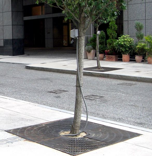

    When I took this photo, my first thought was: What happens when the tree grows taller? My second thought: What happens when the zip tie breaks? The inspector could develop a list of code violations that would run off of this page!
    These receptacles are fed by an underground liquidtight flexible metal conduit (LFMC), which exits the ground and continues right up the tree to the weather-resistant box. The receptacles are used to provide power for holiday lighting. This installation violates the requirements of 300.5(D)(4), which states, “Where the enclosure or raceway is subject to physical damage, the conductors shall be installed in rigid metal conduit, intermediate metal conduit, Schedule 80 PVC conduit, or equivalent.”
