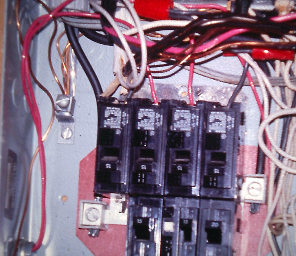

    Which Way is Up?
    The first violation to focus on is the top row of circuit breakers. In accordance with 240.81, vertically operated circuit breaker handles are required to be “up” when switched into the “on” position. These circuit breaker handles are “down” in the “on” position. The bottom row of breakers was installed in the correct position. One solution that would have permitted both rows of breakers would have been to rotate this enclosure 90° so that all of the circuit breaker handles operated horizontally rather than vertically. This would be permitted in accordance with 240.33.
    The next problem with this installation is at the top left of the panel. The foot-lug terminal used for all the equipment grounding conductors is stuffed with far too many wires. Terminals designed for more than one conductor are required to be identified as such in accordance with 110.14(A). The same foot-lug also contains both copper and aluminum wires in the same terminal. This is a violation of 110.14 because devices identified for intermixing conductors of dissimilar metals should have been used in this situation.
    Lastly, in violation of 250.8, a sheet metal screw was used to secure the foot-lug to the cabinet.
