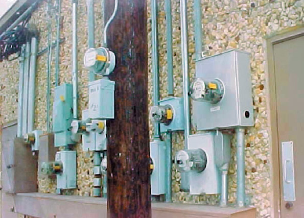

Someone mounted this meter socket enclosure and unused disconnecting means on the pole because the working clearances required in the direction of access to the equipment in between the pole and the equipment (and the other meter socket enclosures installed above the wireway) would not comply with Table 110-26. The missing knockout violates NEC rules as well. Section 373-4 requires that any unused openings in a meter socket enclosure shall be effectively closed with “protection substantially equivalent” to that of the meter socket enclosure. Section 373-2(a) requires that meter socket enclosures installed in wet locations shall be weatherproof. I’m not sure closing up this hole with protection substantially equivalent would make the equipment weatherproof. Weatherproof is defined as: “constructed or protected so that exposure to the weather will not interfere with successful operation.”
