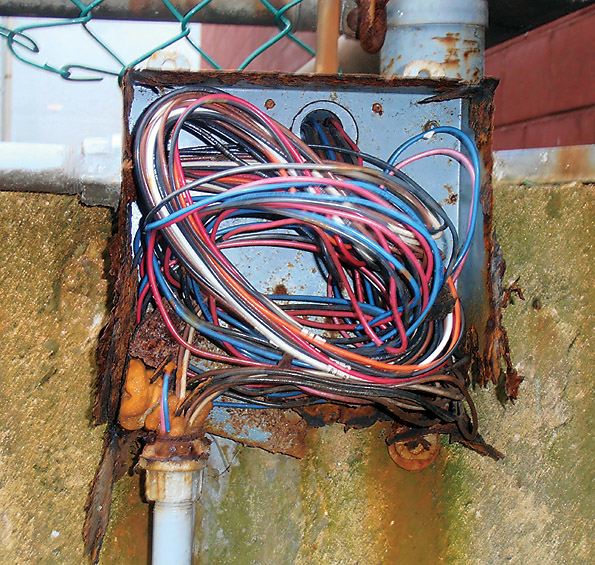

    Ragged, Rotten, and Rusty
    While on vacation on an island in Long Island Sound, Andrew Walter — an engineer for Walter Development Co. — came across this rusted and rotted out junction box at a fuel storage facility. This installation is now a violation of Sec. 110.12(B) because the rust has completely destroyed the enclosure and compromised the integrity and safe operation of this electrical installation. In accordance with 110.11, equipment shall not be used in a damp or wet environment, or where exposed to agents that have a deteriorating effect, unless the components are identified for the specific conditions present in the area. Section 300.6 requires raceways, boxes, supports, and other electrical equipment to be made of materials that are suitable for the environment where they are installed. Obviously, that was not the case with this installation.
    Another problem we can cite is the lack of grounding/bonding continuity between the enclosure and the connected raceways. Section 250.96(A) requires metal raceways, enclosures, and other metal non-current-carrying parts to be bonded in a manner that ensures electrical continuity and the ability to safely carry fault current imposed on them. This requirement is no longer being met with this rusted out installation, creating a potentially serious shock and fire hazard. The box cover, which is missing but required by 314.25, only seems to exacerbate the situation.
