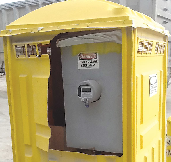

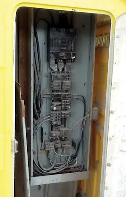

A big “thank you!” goes out to Daniel Cortez, an electrical plan examiner/inspector from Collier County, Fla., for sharing these fantastic photos with us. In Cortez’s own words, “This service (in Naples, Fla.) is inside a Port-a-John. There was an existing building there, but through the years the building was demoed without a permit, and the service remained since it was still feeding a second building. A bright yellow Port-a-John was put over the service so no trucks would hit it since they pass by it all day. At least they have some signage.”
For the most part, I think these photos speak for themselves, but I do want to point out a couple of violations. First is the missing cover for the panelboard. This leaves a severe shock hazard and violates Sec. 110.27(A)(1), since this Port-a-John enclosure is not “accessible only to qualified persons.” Next is the fact that the panelboard enclosure is probably a Type 1 enclosure, rated for indoor dry locations only. Sec. 110.27 and its corresponding Table require a Type 3 or similar enclosure rated for this damp — possibly wet — location. I am not sure if the working space dimensions required by 110.26 are being violated, but it sure looks really tight in that space.

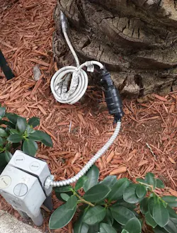

Thanks also go out to Jefferson Morgado with J Tech Security, LLC, Miami, for sharing the photo below with us. According to Morgado, this is the connection for a Christmas lighting display. I can’t tell if the wiring method used was AC cable or MC cable. But in either case, I believe we have a violation of Sec. 110.3(B) since the cord cap installed on the end of the cable is designed and listed to be used with flexible cords and cables — not metal cables. For this metal cable, I am wondering how the grounding continuity was maintained between the cable jacket and the grounding terminal of the cord cap. This would be a violation of 406.4(C) if the grounding continuity is not established. The supporting means for the box is also questionable since it appears to be supported on PVC and liquidtight flexible nonmetallic conduit (LFNC). Neither PVC nor LFNC are permitted as a supporting means for boxes in accordance with 314.23(E) and the Exception. If this is a damp or wet location, 320.12(2) prohibits AC cable from being used at all. The cable connector on the box is not suitable for a wet location. This also violates the requirements of 110.3(B).
