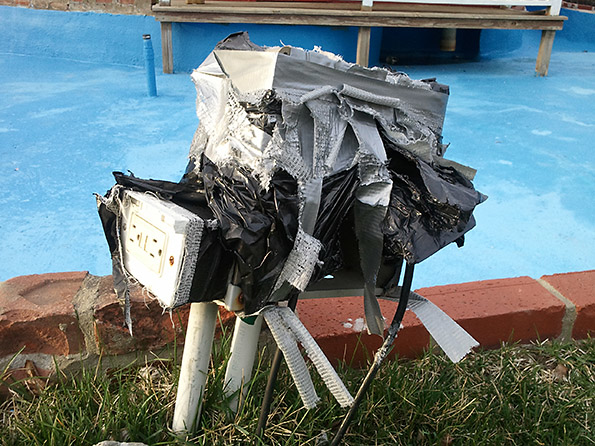

These photos were sent in by a reader who wishes to remain anonymous. He took them while playing miniature golf with his wife. According to him, “This is an area where masses of young people play, and a lot of people with no knowledge of the dangers of electricity come to have fun.”
The first safety concern I will point out is the improper support of the PVC boxes. PVC pipe cannot be used to support boxes in this manner. Section 352.12(B) specifies that PVC cannot be used to support luminaires or other equipment. Section 352.10(H) permits conduit bodies (but not boxes) to be supported by PVC.
My next concern is the broken and missing cover on the receptacle.  Section 406.9(B)(1) requires a weatherproof enclosure for this 15A, 125V receptacle because it is located in a wet location. A listed “extra-duty”-rated outlet box hood and a receptacle listed as “weather-resistant” is also required by this same section of the Code.
The broken pipes and the duct tape used in place of the broken box cover are violations of Sec. 110.12(B), which states, “There shall be no damaged parts that may adversely affect safe operation or mechanical strength of the equipment…”
