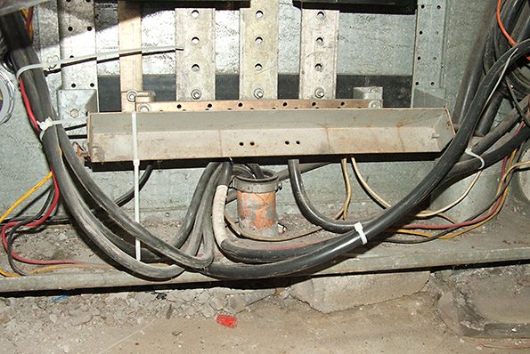

This Job Makes Me Feel a Wee Bit Insecure
I discovered this problem when I removed the cover to this panelboard. The two raceways entering the bottom of this enclosure are not secured to it. This is a violation of Sec. 300.10, which requires metal raceways to be mechanically secured to the cabinet and connected in a manner to provide effective electrical continuity. Exception No. 2 of Sec. 300.12, which permits raceways to be installed without being secured to “open bottom” type of equipment, is not applicable here because this is not an “open bottom” type of cabinet.
In addition, the wiring space below the bus bars where the raceway enters is much too small. The Table in Sec. 408.5 requires a minimum of 10 in. of space between the uninsulated bus bars and the bottom of the enclosure where the conductors enter. These conductors are bent very sharply because of this lack of space and could result in insulation damage. The opening in the bottom of the cabinet where the raceway enters is not completely closed to afford protection “equivalent to the wall of the equipment” as required by Sec. 110.12(A). This opening could allow sparks to get out of the enclosure and rodents to get into the enclosure.
