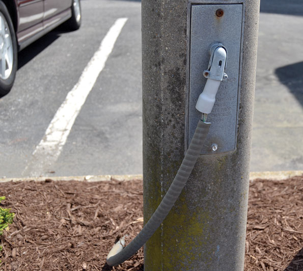

Creative Conduit Cluster
Score two points for creativity, but subtract several for multiple Code violations on this installation. Let’s begin with Sec. 300.15, which requires fittings to be used only with the wiring methods for which they are specifically designed. The flexible metal conduit (FMC) connector in the photo is certainly not designed to be used with PVC. The next problem is the use of the FMC connector itself, which is not permitted for this exterior wet location as specified in Sec. 348.12(1).
Moving on, note the improper use of the coupling on the PVC pipe to connect to the liquidtight flexible nonmetallic conduit (LFNC). This violates the intent of Sec. 356.42, which requires fittings listed for use with LFNC to be used. Next on the violations list is Sec. 300.12, which requires raceways to be “continuous between cabinets, boxes, fittings, or other enclosures or outlets.” Lastly, the use of LFNC for this specific application is questionable, since Sec. 356.12(1) does not permit it to be used where subject to physical damage. It appears the LFNC has been positioned in an area where it could be stepped on.
