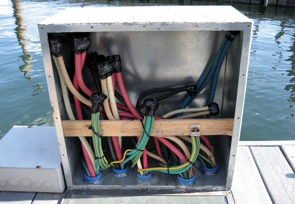

The most obvious violation here is the way in which the equipment grounding conductors are connected to a piece of wood instead of being connected to the metal box. Section 314.4 requires metal boxes to be grounded in accordance with Art. 250. I can’t see any bonding or grounding connections to the box. Section 250.86 requires this enclosure to be connected to an equipment grounding conductor. Sections 250.110(1) through (6) also require exposed, normally noncurrent-carrying metal parts enclosing conductors that are likely to become energized to be connected to an equipment grounding conductor under certain conditions, including (2) where located in damp or wet locations and (5) where using a wiring method that provides an equipment grounding conductor.
As for the smaller box on the left, I’m not so sure that it’s suitable to be used in a wet location. Section 314.15 requires this box to be placed or equipped so as to prevent moisture from entering or accumulating inside of it. It also requires this box to be listed for use in a wet location. This enclosure appears to be a Type 1 General Purpose enclosure as indicated by Table 110.28. A Type 3 or 3R enclosure would be more appropriate in this specific location.
