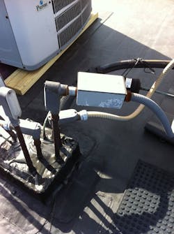

    Rogue Rooftop Receptacle
    This installation violates Sec. 406.9(B)(1) of the Code. When installed in wet locations such as this rooftop, 15A or 20A receptacles must have an enclosure that is weatherproof — even when the attachment plug is inserted. An outlet box hood installed for this purpose must be listed and identified as “extra duty.” This enclosure does not have an “extra-duty” rated cover, and would only be weatherproof when the equipment is unplugged and the cover is closed. This installation is a perfect candidate for installation of a “bubble cover” in order to protect the receptacle and bring it into compliance. The Exception in Sec. 406.9(B)(1) permits a “weatherproof-when-closed” type of cover only if this area is subject to routine high-pressure spray washing, provided the cover is closed during the spray washing. In addition, 125V and 250V non-locking type receptacles are required to be listed as weather-resistant in wet locations.
    Another concern I have is the possible lack of GFCI protection. Section 210.8(B)(3) requires this readily accessible rooftop receptacle to be provided with GFCI protection. This protection could be provided through the receptacle or a breaker or another GFCI device. Exception No. 2 would permit GFPE protection instead of GFCI protection if this receptacle was not readily accessible and was installed for snow melting, de-icing, or pipeline/vessel heating purposes.
    We Don’t Support This Support
    I’ve read Sec. 314.23 over and over, but I can’t find any wording that would justify the support methods used for this box. Liquidtight flexible metal conduit (LFMC) simply cannot be used as a supporting means for a box. Rigid metal conduit (RMC), on the other hand, could be used to support boxes if done correctly. Sec. 314.23(E) permits an enclosure not larger than 100 cu in. to be supported by RMC or intermediate metal conduit (IMC) where the conduits are threaded wrenchtight into the enclosure and secured within 3 ft of the enclosure or within 18 in. of the enclosure if both conduits enter on the same side of the enclosure. This installer used RMC on one side and LFMC on the other. This means that this box is essentially unsupported and can flop around. This could put strain on the conduit coming out of the roof and could cause the pipe to bend or break under the right conditions (e.g., heavy snowpack or high wind conditions). It also appears as though the LFMC is not supported correctly since Sec. 350.30(A) generally requires LMC to be securely fastened within 12 in. of each box, conduit body, or cabinet.
