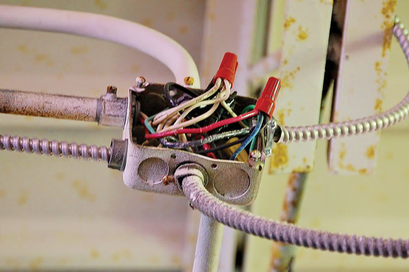

A Variety of Violations
The box is overcrowded. The cables and connectors are loose. The box isn’t properly supported. Green wires are being used as “hot” conductors, and who knows what other problems may not be visible in this photo.
The overcrowded box is a violation of Sec. 314.16, which requires boxes and conduit bodies to provide enough free space for all of the conductors. The minimum box volume must comply with the box volume and box fill calculations outlined in Secs. 314.16(A) and (B).
The loose MC cables are a violation of Sec. 300.10, since they do not establish the required electrical continuity and conductivity for proper grounding and bonding. This lack of bonding and grounding also creates a violation of Sec. 250.4(A)(5).
The lack of proper support for the box is a violation of Sec. 314.23, which allows many options in sections (A) through (H) for supporting boxes — none of which includes using EMT or MC cables for support of a box.
If you look closely, you might be able to see that one of the green wires is taped blue, and is spliced in with the blue, black, and red conductors. Using a conductor with green insulation as an ungrounded conductor is a violation of Sec. 250.119.
