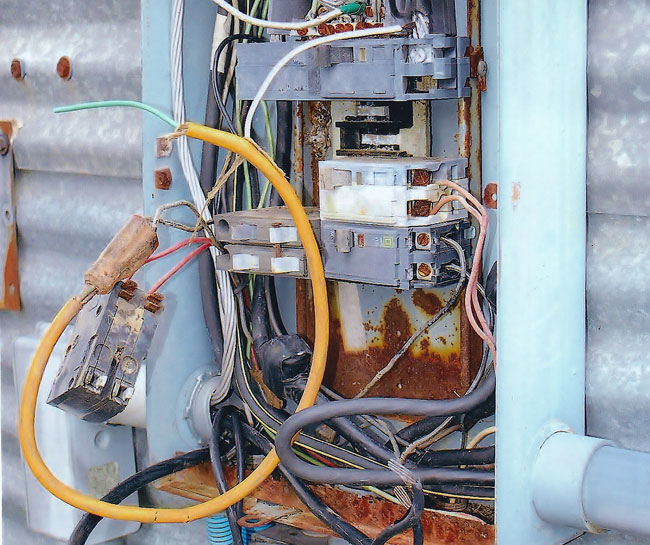

Nathan Crawford, owner of Beaver Creek Electric in East Berlin, Pa., shared this photo with us along with a handwritten note. Although it was a little tough to read, I think it said, “I was asked to come out to a farm to fix a problem they had at one of their grain silos. They were only getting 120V instead of the 240V they needed to run the bin fans. The farmer told me the panel needed a little fixing up. He thought it might be best to replace it. He said he had rigged it to work for the present. This is what I found when I got there.”
I would certainly agree with the farmer’s statement that this panel “needed a little fixing up.” In fact, I would say that might just be the understatement of the year.
The missing cover is a dangerous violation of Sec. 110.27(A) because these exposed energized terminals and conductors create a serious shock hazard. All of the corroded terminals and bus bars are a clear violation of Sec. 110.12(B), since the farmer had to bypass overcurrent protection and resort to some other “creative” efforts to restore power.
