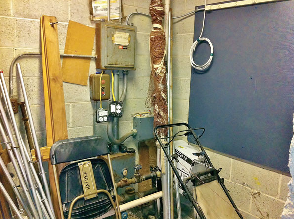

    There are so many violations here that I’m not sure where to begin. I suppose I will start by pointing out the lack of working space in front of this panelboard, as required by
    Sec. 110.26. The lawn mower, volleyball net, chairs, and poles can be moved out of the way, but they still create a violation of 110.26(B), which requires this working space to be kept clear and not used for storage. The water pipe, however, is a permanent obstacle and cannot be simply moved out of the way. Sections 110.26(A)(1),(2), and (3) require the working space in front of this panelboard to be kept clear for a minimum of 3 ft of depth, 30 in. of width, and 6½ ft of height, respectively. The next problem I see is the receptacle boxes dangling off the end of the NM cables. Supporting boxes in this manner can really put a strain on the conductors — greatly increasing the risk of a short circuit from damage. Section 314.23(H)(1) permits using flexible cords or cables with strain-relief type connectors in a manner that protects the conductors against strain and damage. Using NM connectors to support the box in this manner is a violation of Sec. 110.3(B).
