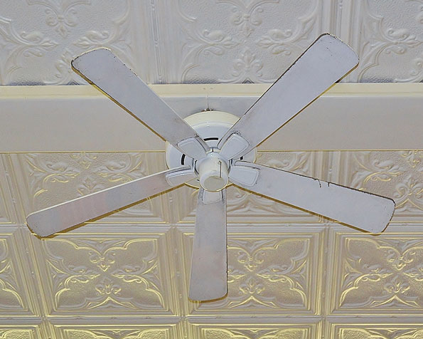

    Fan Appreciation Day
    Looking at this photo raises many questions in my mind — the first one being: “What were they thinking?” I also wonder how the installer supported this fan, and how did he or she route the wiring to it?
    In my opinion, this abandoned luminaire should have been removed. Although there may not be a Code rule that specifically states it must be removed, leaving it in place may qualify as a violation of the “neat and workmanlike” requirements of Sec. 110.12.
    Section 410.64 may permit luminaires to be used as a
    raceway, but nowhere in Art. 410 does it permit luminaires to be used as a support for appliances such as this ceiling-suspended paddle fan. Section 422.18 requires paddle fans to be supported by boxes listed for the support of fans or the fan shall be supported independently of the box. However, this doesn’t mean it would be OK to hang the fan from a luminaire.
    I also wonder how someone would gain access to the wiring supplying this fan. Do the wires pass through the old fixture? Is there a box mounted inside the fixture or perhaps buried above it? So many questions, yet so few answers.
